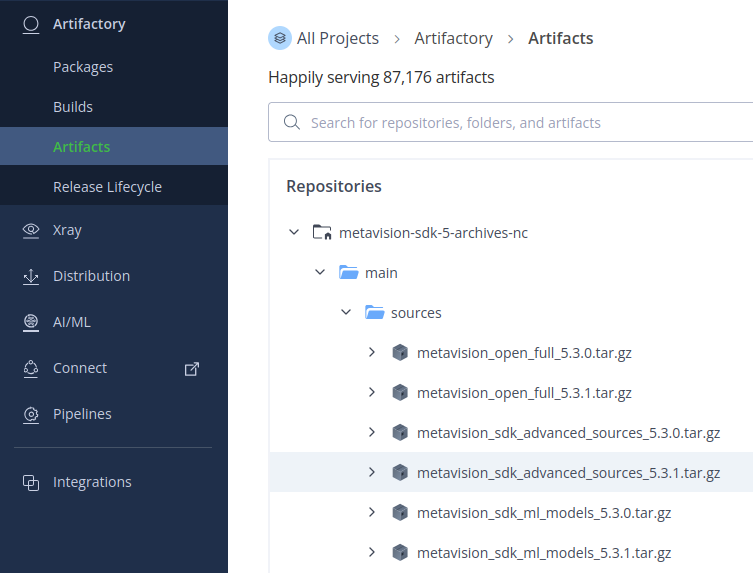

To compile Metavision SDK on Windows, you will need source code archives provided through our JFrog Artifactory APT server.
Follow the steps below to download these archives:
  • If you do not yet have a Prophesee Microsoft Entra ID account, request one by completing this form
  • Ensure you are not logged into any other Microsoft Entra ID domains besides Prophesee. To avoid authentication conflicts, consider using a private or incognito browser window to isolate your login session.
  • Connect to https://propheseeai.jfrog.io
  • Select “SAML SSO” login option
  • Enter your Entra ID credentials. Your login should follow this format: jdoe@customers.prophesee.ai
  • The source code archives can then be found at this URL or can also be retrieved by browsing the Artifacts menu (metavision-sdk-5-archives-nc / main / sources).
    Prophesee JFrog Artifactory APT server
  • Download the following files:
    • metavision_open_full_x.y.z.tar.gz (OpenEB)
    • metavision_sdk_advanced_sources_x.y.z.tar.gz (Advanced modules and standalone applications)
